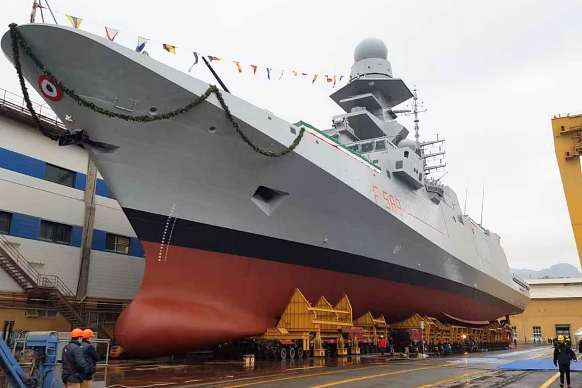

Image : FREMM Emilio Bianchi (Marina Militare)
